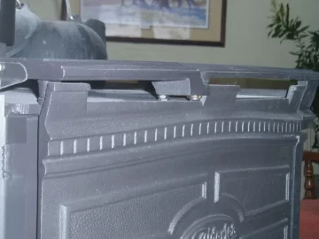

Unfortunately do to several delays in my renovation, it is February and i have not used my stove yet. this weekend i am completing the chimney installation and i set the stove in place today and noticed the top slants to the front. i don't remember this on the floor moder i saw and i was wondering if any of you have this too. There also appears to be two washers under the top creating the pitch on one side is this spoused to be this way or is it adjustable. this is how it came off the create. thanks for the info.

Our T6 seems to be the opposite, the trivet gap increases toward the front.
the placement of the washers makes me think the pitch is intentional or a correction of a mistake but i have not seen many side photos of t5's and i don't remember it in the showroom. if it is something i can adjust i would like to bring it more toward level?
If other Alderlea owners would post photos of the side of there stove that would be great

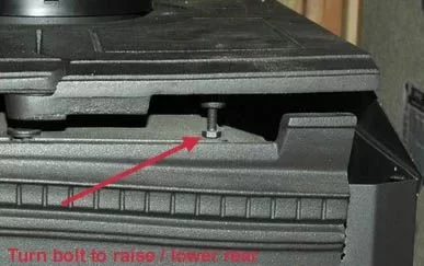

The rear plate is elevated, the cast plate on the rear top of your stove looks way elevated compared to my t6, the gap between that plate and the side is ~ 1/4" where on yours it looks ~ 3/4". I would monkey with the set screw/nut that is visible on your picture if it really bothers your....

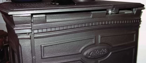

It's a bit hard to take a side picture with a corner install. This is the best I could get. It's substantially lower in the back than your T5.

What you're seeing is the gap between the movable trivet top and the main stove. The gap is intentional and keeps the trivet top at a more moderate temperature than the stove surface. This is great for simmering, and a gentler heat off the top. If you want the full heat, just swing out the top wings and you're right on the stove top.
I would expect the dealer to set check this gap. It appears that my good dealer did.
