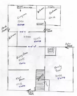

I've attached our floor plan of the bottom floor. We are looking to replace the wood stove. The master bedroom (with no heat ducts) is above the living room w/ the wood stove.
I spoke with three dealers yesterday in my area. I don't think we need the MVAE and husband hates the look of the Quad CB1200, so they are out. I think the big issue is how big of a stove do we need for that area.

Stove size is tough to say. How cold does your house get? More importantly how fast does it get cold? If temps drop does the house quickly follow? If so a larger stove will be needed to combat the cold that is coming in and the keep up with the heat being leaked out. In your case and from what it sounds like you're looking to do you may need to sacrifice a better looking stove for a stove that will output decent heat.

One other thing I haven't seen mentioned in your other posts is to not got too consumed with the S.F. the stove will heat. So much of that depends on the layout of your house, and how tight (or not in your current case) the house is. I would say, buy the "biggest" stove you feel you can afford.
As far as floor registers and fans, I agree with the poster above that any registers and fans will help. The key is to make sure that air currents are maintained. For instance, you can put a register in the ceiling of the LR to heat your MBRM. However, if you have no place for the cold air to be displaced to (ie a return register elsewhere, or say an open doorway to move air to a different room) you will not heat the MBRM the way you'd think. When it comes to your bedroom and living room at the back of the house, a fan on the floor blowing towards your stove room will help heat those rooms a little. Hard to tell if heat can get that far around corners and through doorways. Some people will tell you fans make to rooms feel drafty. You'll have to try it and see if it works for you.
Can you remove that small wall between the stove location and the dining room? I'd say that might help.

My house is pretty open-concept. The stove sits in the corner wall of the living room and keeps the entire first floor at 72F. The second floor stays at about 69F. Our furnace never comes on. A friend of mine has an XXV and his house setup is more like yours - multiple rooms, walls, etc. He uses corner fans in the door frames to move air around.

Based on your description/layout, I would say no less than 50k BTU to be safe, not sorry. Unlike a traditional wood stove, going too big on a pellet stove only results in a small potential loss of efficiency, but gives you plenty of headroom for really cold nights.
I dunno. It doesn't look like a pellet stove in your living room will heat your house, so it's not really a long-term solution. I'd think about an inexpensive pellet stove for the living room, and an electric heater for the upstairs master bedroom. Then, after all your insulation projects are done, you can give some more considered thought to the problem.
I'd rather go for the replace the oil burner with a pellet furnace solution. Then, all rooms get heat for less money, ultimately.

I would install your stove in the dining room since it is a more central room of your house
We installed ours in the dining room
Would it have looked nicer in our living room? Of course. But our goal was to heat the entire house with our stove and it does a pretty good job
