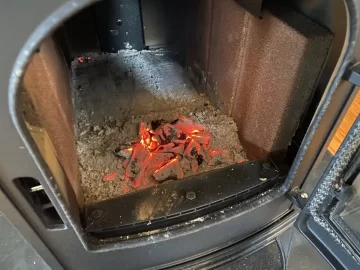

Well, just toss some splits on top and go, probably not. But you can see in the pictures I had enough coals to get a few pieces of kindling going, added a little more kindling, then put in 4 small splits and ran it to 500* and now letting it die back for the day.
Are you implying that one split of wood at midnight gave you coals suitable for a reload at 10am?
I was wondering the same.
I think this is not a cat stove, so I'd also be concerned about smoldering too much.

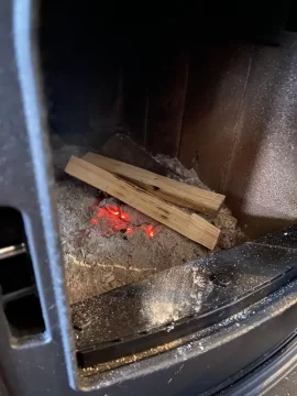

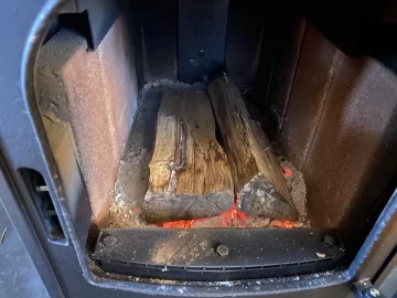

This it’s what’s left 4 hrs in with four small pieces of really dry maple. I raked it up, pulled up the coals and put some thin pieces of hickory on top to see if it takes off.

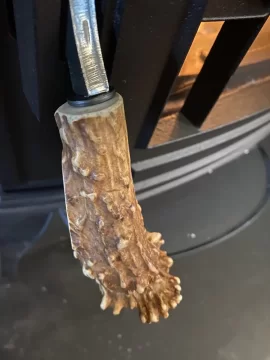

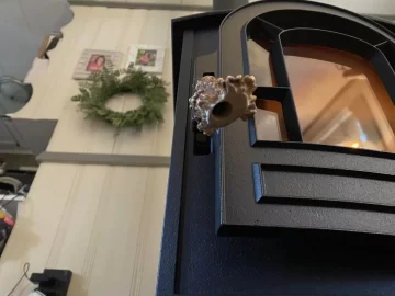

Gonna see how stinky or hot to the touch an antler gets.
[Hearth.com] Am I Being Silly?

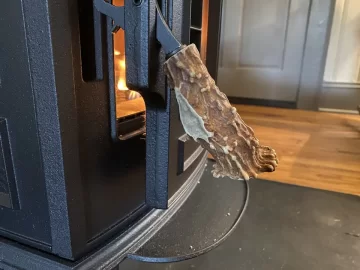

Got the factory black handle back on. The wife came home sick. She can smell anything on a good day, and has spidy senses when she’s sick. If you’ve ever cut bone or antler on a band saw, you know the smell. I got ahead of myself and should have just let it sit in the building to air out a while after I cut and drilled it. I guess already puking and smelling freshly cut bone in the house didn’t agree with her.

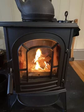

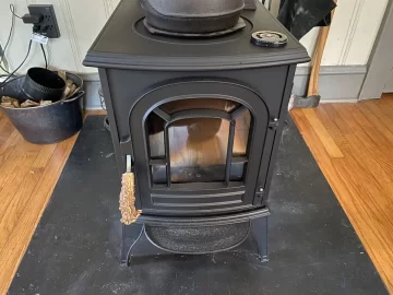

Looks like it runs about about the same speed as my old stove. 2 splits is comfy, 3 splits is a little warm. These were smallish splits, but I don’t need 600* unless the ice knocks the power out.
2 splits it is. Maybe I’ll add a damper when I get the appliance adapter.

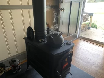

Steam pot is putting out the steam with a trivet under it.
Door seal is good.

With the automatic air control I wind if you will be chasing your tail if add the damper.
That’s a good looking stove. Best VC available now IMO. Glad it’s working almost got one myself but went with a big insert.

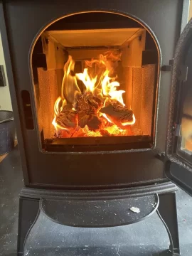

I’m gonna let it die down. It’s warming up outside. I’ll mess around with it more when I have the proper connector and will try a larger split instead of smaller ones. Maybe part of the problem is that it’s actually warm enough that I don’t need a fire today. I was just working on breaking it in. I just didn’t mean to get that hot with a couple little chunks of wood.
With automatic air control it’s going to try and achieve the pre set temp. And it’s probably hotter than you want today. And hot enough to get clean burns to me emissions.

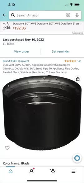

I would use single wall with your set up. Looks like plenty of clearance and you will get a little more heat out using single wall.

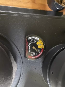

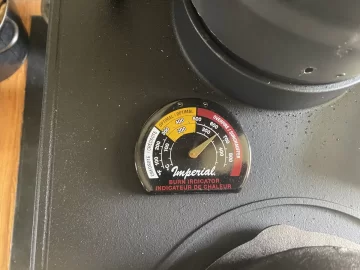

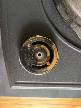

It looks like the stove wants to cruise around 650º at peak burn so far. The Imperial thermometer temperature zones are for single-wall stovepipe and not relevant for stovetop temp. Overfire on this stovetop would be more like 800+.
Reactions: ispinwool and Todd
That makes me feel better. I didn’t see anything in the documentation. I’m also finding VC to not be very helpful. I sent them an email before I bought the stove and never got a reply. I’ve tried to call and ask about a question about the auto damper and temp range, and another time about the flue adapter. They just forward you to the local dealer when you enter your zip code. This would be the same dealer that said I didn’t need an adapter when I bought the stove, then tried to sell me a single wall adapter when I told them I needed an adapter. (6DBK-ADSS) maybe it would work, but it just didn’t feel like the right part. About like my temporary fix.

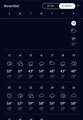

Anyway, if that dude can run 7-800, 6-650 isn’t so alarming. I’ll just need to manage load size for comfort but it’s still too warm to tell what that is. It was cold a couple weeks ago. 70+ today and the A/C is on now. So that’s not a fair judge. It wasn’t trying to warm the cold bones of this old uninsulated house.
Reactions: Todd
Mowed the lawn in a t-shirt today! November 12! Usually I'm wearing a jacket to zoom around on that mower (self-imposed wind chill!), by the time the sun is setting this early.
Like 78 yesterday. 71 today but getting ready to dip down for a bit.

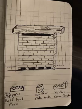

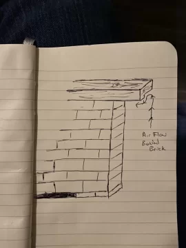

So I’m thinking of adding a shield. I have some 3/16” steel, but like the idea of adding a brick and beam mantel. I have a wet saw and can cut the brick.
I’ve not seen any brick veneer sheets that actually looks good.
If I cut the brick in half to keep a lower profile, and left an inch to an inch and a half gap behind the full surface area except for the corner brick, I could tab it to the wall in the corners. I’m thinking about 4-5’ wide and about a foot or two above the chair rail. ( I’d have to take a look at the top clearance to get the beam height.)
Then top it with a beam to set some junk on.
I can either do a lintil along the bottom or do 1” thick half brick under each bottom joint along the floor.
Any thoughts on this ?

Also wondering if the bottom of the beam was recessed a little the top vent wouldn’t be so visible. As in, if the brick was 3.5” off the wall, and the beam had a 1” deep x 4-5” wide recess all the way across the bottom-back edge, it could overhang the vent without blocking it.
So I ask again, Am I Being Silly?
I can always cut the steel sheet I have and maybe cut a design on it with the torch, I just think real brick would look best with a nice beam on it.

I believe you will want a vented shield, not something stuck directly to the wall, if operating at close clearances is your goal. This is most often sheet metal spaced off the wall with 1" standoffs, and free air movement around the entire perimeter, but other materials may be possible. It may even be possible to make the shield out of those bricks on green board (@begreen?), if that's the look you want, but you'd want to space it off the wall with ventilation all around.
That’s the intent. The face brick in the sketch would be cut in half. The corner brick is notched, with gaps along the top and bottom. Air can enter beneath and exit above.
The Lowes link, Thin Brick on the cement board would be spaced off the wall with gaps above and below, then a beam suspended above. I may not have stated that clearly, but the corners would be boxed in, creating a bull brick appearance from the sides with the offset off the wall.
