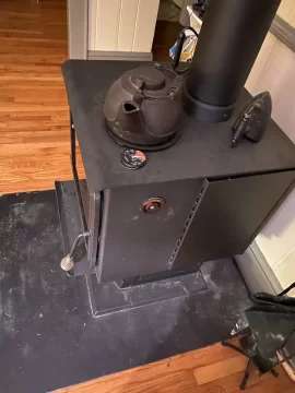

I have an 1100sqf house in central NC. I have been running a England or Summers Heat, or whatever brand and you want to call it, in 2000sqf flavor stove for about 5 years. I got the 2k size cause it was a deal at the time, and I thought I’d rather have overkill than underkill. Now, I only ever run 2 splits and a time. If I burn 3 splits, you can’t stand it, and I get a little worried if I see 650-700 on the stovetop since the book says 600, if I recall correctly. That’s probably just my naive self, trying to follow the rules and all, but about 400 at the stove top is about right for the space as well.
I’ve been looking for about a year at other options. I’m was all about a nice enamel stove for a while, a soapstone, or something nice, but I don’t think I want to spend $3k till I know what fits.
My stove is also too big for the room aesthetically.

So I’m thinking of trying out a smaller stove, but it looks like, in general, at 1100sqf, I’m either maxing out a stove, or right back where I am.
So do I keep slow rolling what I have, or go with an Drolet Fox2 https://www.drolet.ca/us/en/wood-stoves/db03186/ or US Stove Defender (broken link removed) ? These meet my clearances without either building something or putting it further out into the living room of an already small room by using some 45* bends in the pipe.
I like the stepped stovetop and legs better on the Defender better. I like the fox on the door of the Fox, and its North American manufacturing gives me a fuzzier feeling.
The US is an E/W loader, and the Fox is a N/S loader. This means that the US is going to appear a little more inline with the wall than the Drolet, even though based off flue location, they will both extend into the room roughly the same.
Seems like for the size of them, the N/S loading will be better than trying to stuff a small box E/W, and potentially spilling against the glass as it burns down.

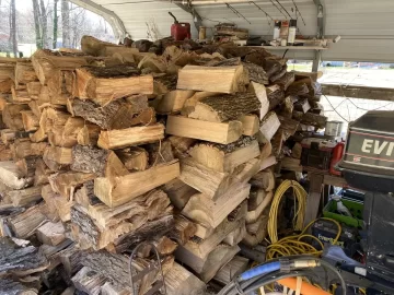

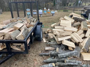

Splits are decent size. [Hearth.com] Am I Being Silly?
Some of these got split again. This was just splitting them quick with a maul to get them off the side of the road. The ones that are stacked are finished product.
I’ve only been burning oak, hickory and ash. A little Bradford Pear, but I try to avoid it.

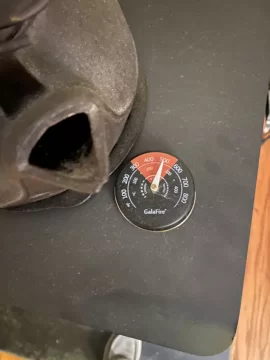

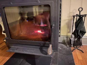

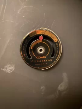

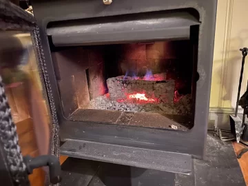

This is tonight. 500* and there is hardly anything in it.

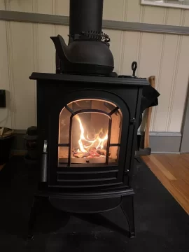

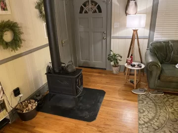

I have the VC Aspen C3 ordered.

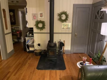

Looks like it will fit nicely.
Only thing I’m a little iffy about is the spring controlled air intake damper.
If I’m thinking correctly, the spring heats up, expands and the damper begins to close down. If that spring starts to fail, it would likely fail in the closed/expanded position as it wears out, so the only issue would be insufficient draft. However, if it failed open, what would happen?

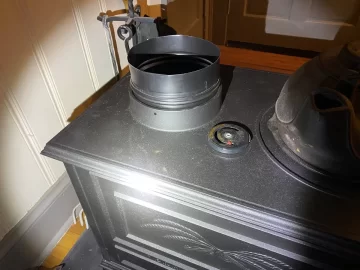

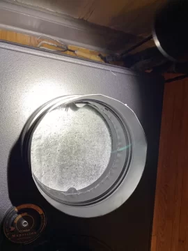

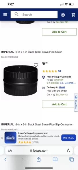

So the VC C3 is here. The dealer said I didn’t need an adapter when I ordered it. Guess what. I need something, because the 6” double wall is the same size at the vent collar.
What is it that I need?
Otherwise it’s cute and look like it will do the trick.

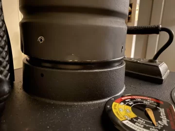

Will this fit into the stove collar and inbetween the two layers of double wall?
Oh how I wish there was a standard mandated for flue collar ID and all double-wall was standardized for that diameter.
Alas, it is not. You may need the appliance adapter from the stovepipe manufacturer, but check it's sizing. VC stoves can be challenging this way.

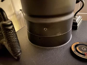

Although I don’t feel good about a permanent fix on the pipe, I got a small break in fire going.

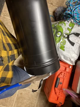

I ran to lowes and grabbed a couple things to try. The male/male adapter was way too small.
I also got a single wall telescoping adapter. I trimmed it and crimped it to fit into the collar, and trimmed it to slide between the layers of my double wall pipe.
I’ll keep looking, but atleast I have a low break in fire for tonight. I’m sure I’ll kick the LP heat on in a while.
