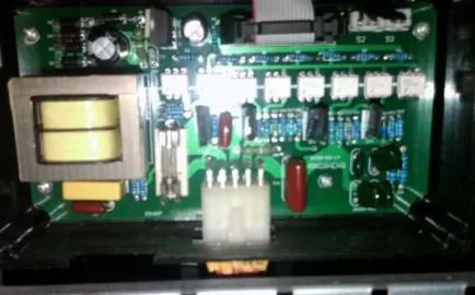

I'm going to dissect this tomorrow and write down some of the components part by part.
The top row of white look like timers to me.
With my mag glass tomorrow I'll get the number off them.
Lower I see all the resistors to control what can happen when the above timers allow it.
I believe this is where the change may need to happen.
Capacitors below that and in the upper left where the ribbon curls (sorry about that getting in the way).
Obvious ribbon connect and the sensors coming in on the upper right.

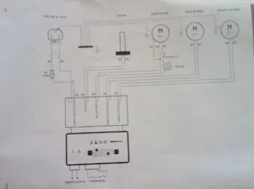

They're supplied schematic, shall I say, sucks....
If I can guess with this only being divided up to four functions : ignite, auger, room blower and exhaust blower, then I assume the timers are paired.
This is the 'dumb ass' moment when I can't figure why or what the other 4 functions are...
Here comes the pic's.

Sorry, forgot how to do 2 at once....
  • [Hearth.com] Am I burning too good a pellet?

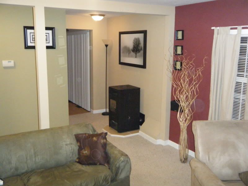

here is my stove
it only heats my living room and kitchen (about 1000 square feet) and my house is really well insulated so hardly ever have it all the way on high, even on the highest settings. Today I'll burn it on high and see what kind of temp it is putting out. If it's similar to yours and my stove does not shut off that will tell us a little more.

This circuit is killing me...

New 'control board' came in and installed it.
Kinda disappointed to see they believe the user push button pad to be the 'control board'...
The true 'control board' is in the circuit board...
Even with my limited knowledge here, I know where the 'real' control is...
The 'circuit board'!
