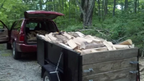

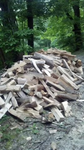

My wood score for the day!! Really excited about getting some dry wood. I think it is yellow birch :cool: It is almost a full cord!

Kinda hard to tell from the pics but that wood looks solid from here. Yellow Birch is about like White Ash heat-wise, very good stuff. If it's anything like the River Birch I cut last summer, even if it's a little wet it will dry really fast. Mine was fresh-cut wood, sopping wet, but was dry in a few months.
Nice score toddnic. Looks like you are making "progress".

Wood lengths are anywhere from 16" to 22".
Did you pull that trailer with that van? The van doesnt even look squatted down in the back.
The vehicle is not a van. It is a 1999 Dodge Durango with a 5.9 engine with 268,000 miles. It is a workhorse!! I believe in getting every ounce of $$$$ out of my vehicles.....unless it is my wife's vehicle....then it is only a few years old ;)
I had the 5.9 2001 i think. Only lasted half of yours with regular maint. wasnt upset because it got around 14 mpg
