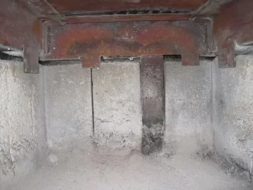

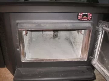

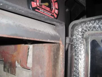

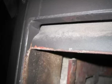

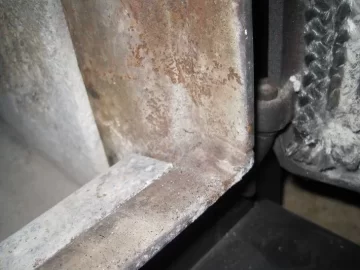

Ok, more pictures as promised. I don't see any other issues but I did not remove the baffle ( i know its warped) or rails and inspect them all. Have others with this issue done that? any other suspect welds?

wxman, thanks for posting the pics. as u can see in my pics, pe has made some changes in the pacific insert. the ash lip is different, but also there is a seam running vertically down from top to bottom along the edge of the door. that seam is welded on your stove, but on mine its not welded, so they definitely have changed the way they put the fireboxes together.
I don't think that seam on mine is welded, I think the pictures are decieving. Will check it tonight.
Emailed Cory at PE this morning. Did not get into specifics except the $150.00 limit that was being imposed. He said $150.00 is based on average repair for this type of failure. He instructed me to get an estimate to reweld and then we can discuss any reimbursment limitations. I will also get the welders opinion as to whether or not a weld is the correct repair. Third time a charm?? Any good mobile welders on Long Island??
