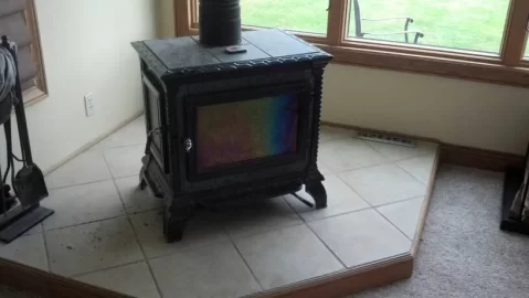

Thought I would share a pic of the supply vent near the stove. Its on the right side on the exterior wall . Figured it may help get more of an understanding of what I'm gonna try.
This vent will be isolated from the rest of the supply vents. The fan will draw air from the the supply side of the forced air furnace which the house has 3 supply vents , 1 in the hall around the corner and 2 more in the bedrooms. Hopefully I can get a fair amount of cool air with the 8" fan. I'll be sure and post pics and do a little " not so scientific" experimenting.
