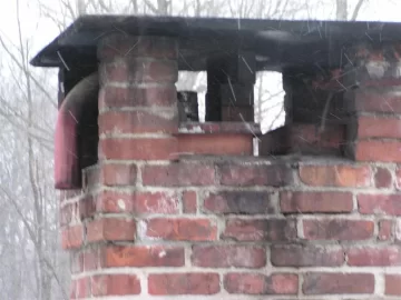

I have a Quad Mount Vernon AE and recently had it on high to heat the house quickly. I just happened to walk by my front door, and thought it was left open. It turns out it was closed and the air being sucked through the was ridiculous (no wonder it seems so drafty). Anyone running an oak up through the chimney with a Quad? The manual shows this as an option, but my dealer says I don't need it and besides there is no chimney cap option that supports it.
I have a 3 inch OAK and exhaust running up my 15 foot chimney flue. I also have a blue stone cap on the top of the chimney. By code you have to have a height difference, intake being lower, of at least 12 inches between the intake inlet and exhaust outlet. I had to get creative on this setup. I got a 3 inch 180 degree U bend from the auto parts store and then cut a hole in the stainless steel flue cap where the exhaust exits. I mounted the U bend, sealed the connection to the flue cap and attached the 3 inch flexible aluminum duct to end of the U bend under the flue cap. I now had the separation required by code and the inspector said he never seen nothing like that before. The inlet of the U bend hangs to the outside of the chimney. I had to make a 3 inch adapter to attach to the back of the MT Vernon Insert, flat plate with a straight piece of the 3 inch U bend I cut off welded to the flat plate. The inlet duct and exhaust also run through a sealed plate where the chimney damper was. Even on the coldest days the intake air gets warmed by the heat from the exhaust when they are running in the same flue. When I put my hand on the intake pipe it is not as cold as the outside air. Don't have any pictures but will try to get some up sometime soon.

To FordMasterTech--
Any pictures you can provide would be greatly appreciated!

I thought I had some pictures of my OAK termination at the chimney but couldn't find them in the computer. I took a few from the deck and a upstairs window today but nothing showing the U bend attachment. I wasn't going up on the roof today with the storm brewing. The bricks you see laying on top of the flue cap are there to support the blue stone, it has a small crack in it and I didn't want it to fall down' I'll get to it in spring. Hope these will do for now.
