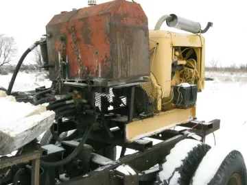

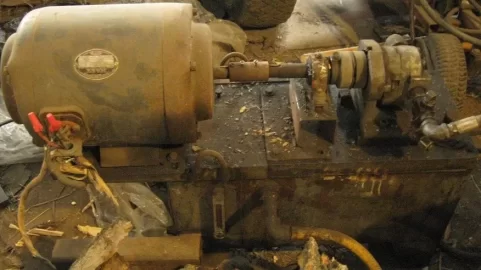

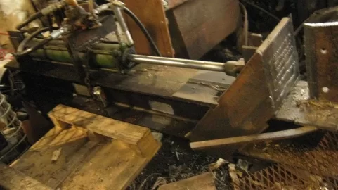

I have built an electric log splitter and a gas log splitter and have a manual log maul. The gas splitter was made so I can put a larger splitter on the ground and split 40inch or bigger logs in half (I got two 7inch cylinders for that).
Any one else build themselves a sweet splitter or seen one?

I see you have an adequate exhaust system. ☆☆☆☆

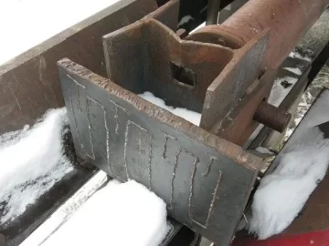

The steel looks fatigued on the push plates. Does it run?
Does it run in the cold?
Do you need ether?
It looks non-girly.

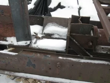

The push plate is 1 inch thick plate and I wrapped the beam (boxed the beam) 360 degrees with channel iron and 'I' beam underneath. I split wood that twists the push plates and learned - box in the push plate around the beam. It runs good, it has a tank heater on the engine. Just have to let it warm up awhile for the hydraulic oil but when it is that cold out, I use the electric splitter in my shop. The bent piece in the picture is not the contact part with the wood.

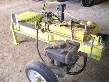

For a single cutting edge I can't even imagine the need for a cylinder larger than 5" in diameter. I deal with some pretty big and ugly stuff and my DIY unit handles them admirably.
