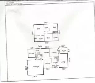

Currently I have an oil forced air furnace. I added quite a bit on blown in insulation to the attic this past fall. We went from a R-19 to a R-48.
I am planning to switch out the air conditioning unit for a heat pump this summer or fall.
I also am considering the following projects.
An efficient wood burning insert in the fireplace (Jotul Kennebec or Rockland)
Or pellet stoves in both the living room (cathedral ceiling) and finished basement. For both these locations I think it is a benefit not to have to run a chimney and was key in thinking of a pellet stove.
Additionally the "porch" off the family room is now open to the rest of the house, I framed and insulated it.
Any thoughts on these plans?

Good work on the insulation. That's money in the bank (probably even better). My first thought after seeing the plans is that this is going to be a tough one to heat evenly. The stove will be on the end of the floor and there are lots of small doorways instead of open passages for good airflow. It could be that the Rockland will be too big as an area heater here.
I don't think you could get an even heat like BeGreen said. My insert is in the middle of the home and it still is cooler in the bedrooms. If only the home could be zoned!!! I think you will help with the heating bill but to eliminate it would be too optimistic. You will live much more comfortably in the living room and adjacent room with a heater!!!
