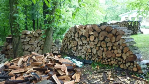

Here's some of the stuff we scrounged up that's about ready to go: Cherry, Red Elm, Mulberry, Redbud, and a tiny bit of Walnut in the first pic. Will be burned this winter.

And stuff for the following winter, mostly White Ash.
