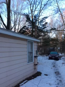

I've tried to answer the questions below, and I added an image!
Are they going thru a wall & up the outside? - The installer suggested going up through the attic and out the roof, rather than out the wall
How many floors? - One
What is the pitch of the roof? - Attached photo; it's basically a garage
What is the wall made of? Block? Poured concrete? Framed? - Framed
Are they going up through the inside? - That was the installer's suggestion
How much connector pipe? - I see a "40 to 68 inch telescoping pipe" on the quote ($201)
How much Class A? - Six feet ($267)
Are offsets required? - No I don't think so

I am sorry but there is no way what so ever to tell much at all about the install from one pic from the outside. I would be worried about not having enough height on the stack though that stove calls for 16' above the stove
Wasn't just the one pic that I guesstimated with. He said basically a garage. If it was a converted garage then it's probably not a complicated install. If he reads all the directions, asks a few questions and has the correct skill set he should be fine. It's not as easy as pounding a nail but it's not rocket science either. If he has the slightest doubt then by all means pay the professional since the possible risk of a bad install isn't worth your house burning down. 1000 bucks is a bargain in that case.
I do agree that in this case it probably is not going to be very hard and $1000 is probably pretty much. But to tell some one it will me simple with little to no info on the install i feel is not the right approach. I have seen many instals that on the surface looked pretty simple but once you really started to look things can quickly get complicated.

The bid seems a bit high for what should be a simple install with minimal chimney. My first concern is that stove may not be too happy with 11 ft of flue. The manual recommends 16ft of flue.
"We recommend the length of the chimney system should be at least 16 feet (not required) above the stove in normal domestic situations, measured from the flue collar to the top of the chimney."
Also wondering how large an area is being heated? This is a small stove.

Yes it's basically a converted garage. ~375 s.f. I do think that the install will be pretty straightforward, but I'm glad to hear that the quote is at least in the ballpark. I hate feeling like I might get taken, especially being female.
Any opinions on whether it's best to go straight through the roof, or out the side wall and up?
Since you will have trouble even getting to the minimum length, a straight shot up and keeping the chimney as long as possible in the home envelope will be better for draft.
