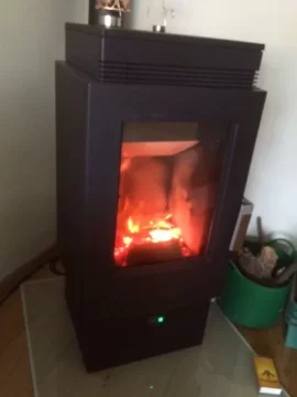

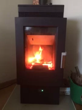

Here are some pic's...
The green light starts blinking red when you have to add wood...

(sorry for the turned pictures, the hosting software turned my pictures)
Pics now rotated correctly.
Does the white and brown panel on the right side cover the electronics and air control servo?

No, the white (it's alumina color) an brown (wood) is the handle to open and close the door...
All electronics are under the stove... you can see the temperature sensor on the right picture, it's on the upper left side of the burning chamber.
The regulating system is very easy:
starting: primary an secondary air on for 20 minutes, once ideal burning temp is reached primary air closes.
burning mode: secondary air is closed slightly when burning temperatur is too high, it is opened when temperature is too low.
when the wood is burned, the temp decreases and the led turns red...
adding wood: primary and secundary opened untill ideal burning temp is reached, then primary closes en secondary regulates.
There is also a grid you can open when lighting the stove when there is almost no draft...
this is how the rikatronic 1 works, now they are on the 4th generation (rikatronic 4) and the functioning might be slightly different.
