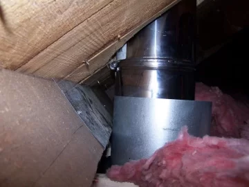

Anyone want to play what's wrong with this picture?

Is this in your home?
Sorry to see this. It looks like the installer had an "o chit" moment and proceeded with wishful thinking.

Yes, this was after they had to come out and "redo" the whole thing because they had single wall 8 inches from similar wooden beams at my ceiling.

Yes. The first bad install was one of their "teams" and then the redo was the owner himself "with their best guys". (And you might be asking why did I let them fix it if they did it wrong the first time, but the code enforcer was supposed to cover that.........)

Not a chance, they saw it all. It's been 50 days, had a near chimney fire Tuesday, had certified chimney inspector out today and he found it.

Did the inspector give you a written report? If so, I'd take it right down to the shop in person and start questioning what happened since they were given 2 chances to get the job done right, and failed both times.
How did the pipe inspection come out (other than the apparent fubar ceiling penetration)? Was the actual pipe cleared? Did he find any indications of a "real" chimney fire or was is just an over fire situation??

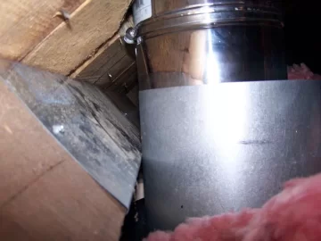

I like the piece of tin screwed to the beam. Effectively reducing clearance to combustible by 2 millimeters. Redonkulous.

I think that emailing them those two photos would be enough to convince them that the job still hasn't been done correctly.
Be careful or they may come in with a sawzall and cut the 2" clearance out of the wood.
Is the chimney vertical? In my experience, the yahoos will try and bend the chimney over to try and gain every possible bit of clearance.

How would this help? The photos already provided show that there is an issue.
