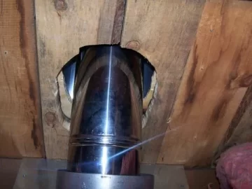

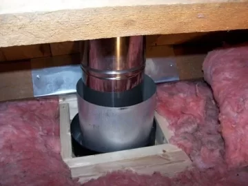

Anyone want to play what's wrong with this picture?

After reading this underlined part, and looking at the picture again it is quite possible that somehow that top of the chimney has shifted or is leaning to the left somehow, and that is why it is not only too close to the insulation shield, but also looks too close to the roof cut out on the left as well. Still doesn't make it right because the top of the chimney should be secure enough that it can't move, but there may be some truth to what they are saying about it being moved out of place. I would get on the roof and see if that chimney is so loose that it moving around up there.
She claims they did it right and the firemen pushed it over.
I'm gonna say that's not out of the realm of possibility. The sheet metal 'heat shield' on the beam adds doubt, though.
Except that on the right going into the ceiling of the attic there isn't enough clearance to move it over and still have 2 inches there. These people originally put single wall 8 inches from a wood beam. They get no benefit of the doubt from me.

Thanks Pete. She claims they did it right and the firemen pushed it over.
It does look like it is up against the shield on the left but there is still an air gap between the pipe and roof sheeting. Unless they have a 4" air gap which is unlikely they installed it wrong. It looks like an installer who was drunk installed it to me !

These were taken before the firemen were here. A few weeks before. [Hearth.com] Anyone want to play what's wrong with this picture?[Hearth.com] Anyone want to play what's wrong with this picture?
Hmmm. Yes, another dimension. The second picture clearly shows the pipe off center in the insulation shield.

Even though you can't see the back, if i took the same photos we could see if it has been moved, maybe i will tomorrow.

This is not relevant to the topic. Keep her and yourself focused on the code legality of this installation and don't get lured into a discussion about the high temp fire. You were to blame there for spacing out the fire. Stick to the improper installation. It violates the manufacturer's specifications and that will void warranty. Your inspector already knows more than the fire chief. Don't go there.
Is that class A crimped into stove pipe inside the insulation shield? Aside from the obvious, something just ain't right about those pipe sections meeting in there.
Or maybe just reflection of the pink & the shield?
No I think what you are seeing is the relfection of the outer shield on the reflective Class A.
