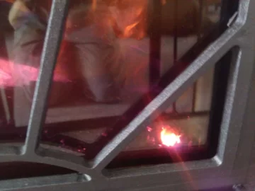

I wanted to followup with a picture of the door latch, I am not crazy about it, it is not the easiest to open and shut but I am sure with time it will wear down and smooth out, which also worries me, it doesn't look easy to replace if something happens to it, I am guessing the whole handle would have to be replaced.

with out bending the latch, or welding on a thicker latch back plate there is really nothing to adjust on the door, if it is fully latched and the gasket is still not tight it might take a re-gasket.
does it pass the dollar bill test on the top/bottom and hinge side?
I've got 3 Appalachian inserts on display, they all had hard to close doors(sloppy for sure!)
i had to take a file to the latch on all of my display models to make them smooth, also added a lil anti seize lube
as for the ashpan, it is gasketed but doesn't have any latches to keep it tight against stove, again, sloppy!
dollar bill test wont work on this door, so try a smoke check and see where the gasket is light/missing etc.

Yea I did the dollar bill test and only the latch side is not sealing, before I do anything I wanted to test Appalachians customer service and see how long it takes to get an answer.

i think you'll end up re-gasketing the door... dry fit it before glueing to be sure of a good fit this time

i dont see any easy way to gasket the rod. its just a metal rod passing through plate steel.
Mellow,
I tried a fix on my floor model and it worked pretty well. I am sending you two different sizes of gasket material for the door, a dense 1/2" rope and a less-dense 5/8" rope. See which one works best to fill the gap. I am also sending about 6 feet of the self-adhesive gasket shown in the pics and some high-temp silicone for the rope gasket. I hope this works well for you. If not, holler at me and we will continue to work on a fix. Thanks!
