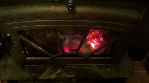

So I finally got sick and tired of the ash drawer leaking air. I have to have a ton of ashes over it or a log on top of it so it blocks the leak. The wife emptied the ashes (we don't use the ash drawer) and I was in a hurry the other night to load the stove, ran the logs N/S and due to the leak in the ash drawer my cat was pegged at over 2000 deg even with the bypass open.
So fast forward to Saturday, I went and bought some furnace cement and sealed up the opening to the ash drawer, I would have a pic of my cement job but the kids got on my phone and deleted it. My pics of the air leak during the fire made it through the kids delete spree on my phone. Tried re-gasketing the ash drawer and lever but still could not get it to seal good. So the ash drawer is now for looks only.
The stove is much more controllable now and I am getting longer burns to boot. Now I can close the air down fully and let the cat purr along at 1500. Also noticed I am not getting any blow backs with the air turned all the way down.

Also Saturday after finishing up the cement job I thought I would inspect the cats, so I go to take off the cat shield and the first bolt comes off without a hitch, go to work on the second bolt and it gets halfway and snaps, ugh, so I had to drill that out and retap for a new screw, after that I got around to inspecting the cats, they looked great, still brushed them off for kicks and giggles and put the cover back on.
UPDATE: Since sealing the ash dump and replacing the door gasket I have a much more controlled stove, this thing loves to have the air shut down completely (cat runs hotter), have not had any blow back issues so far and I am amazed at my burn times now, burning gum wood I am now getting 12 hour burns. I loaded up the stove last night at 8pm, closed the air fully at 8:30pm and when I checked it at 8:30am this morning the cat was still purring along at 450 degrees and it was still putting out hot air with the fan on high, it could have gone longer than 12 hours but I had to reload it to get to work.
