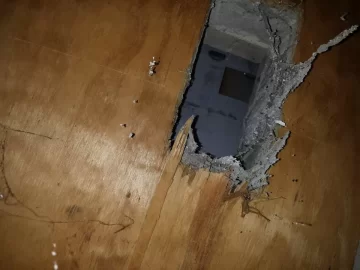

Interesting, I have the same thing happening in my fireplace. You can see the bottom of my summit in the picture that I took when it was being installed.
