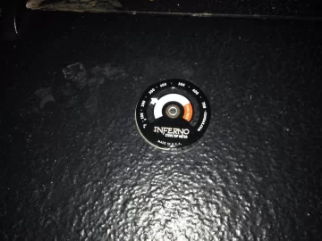

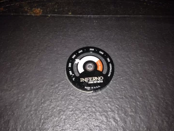

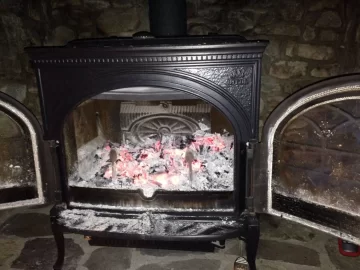

So, I emptied my ash pans last night, and decided I'd take some photos after today's burn. Loaded at 6:30am, and these photos taken around 6pm, so this is at 11.5 hours into the burn. Empty ash pan, on two old Jotuls.
Stove 1, 15' chimney, draft set at 5% - 10%:

Stove 2, 27' chimney, draft at 0%:

Coals, about the same in both (same photo, with & without flash):
[Hearth.com] Ash tray Empty or leave ashes

Wow!...just imagine if you'd left the ashes in!
