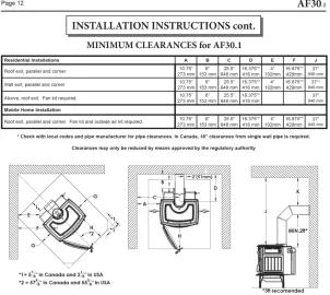

See attached file for clearence specs

The hearth needs to protect 8" behind the stove, 8" to each side and 16" in front of the door, so add 16" to the width of the stove and 24" to the depth. If your local regulating authority allows you to put an NFPA 211 wall shield behind the stove then the rear clearance can be reduced to 12".
So there can be a strip of bare floor behind the stove between hearth and wall?
Just asking.
Yes, especially if the flue goes straight up.
Good point. To clarify, it depends where one is measuring from. It's 16 3/8" from the stove body, but 6" from the furthest rear protrusion.
