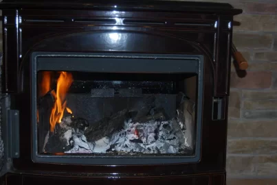

[Hearth.com] Ashford first burn ? This is what's left after 22.5hrs still active cat, leaving for a my daughters away volleyball game so I most likely will not be here to see the end of this load.

Isn't it great! I love how clean the glass stays on it too! Ashford did a great job with the air wash design.
Reactions: SCOTT S.
Try again in colder weather. Draft will improve substantially, powering a better air wash.

Loading technique (both position of logs and diameter) can influence air flow across the glass. Draft and corresponding burn rate can also play a role in how clean glass will stay. Smaller diameters with more air passages seems to help as does drier fuel.

Your glass stays clean? Mine turns black. What gives?
On average, it's the cleanest glass of any stove I've used. Most of my others would dirty up the glass most of the time unless I could run on high for a while. That's hard to do in the shoulder seasons.
