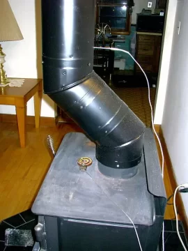

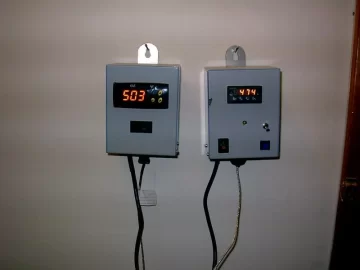

Interesting idea, On my stove I have 2 temp monitor alarms, one for flue temp and one for stove top temp. If the alarms go off
my house is small enough that I can hear it no matter where I am.
I did consider some ideas to automatically close the air if the temp goes too high, but I haven't done anything yet.
Some other possibilities, take a look at using a HVAC damper motor instead of a air cylinder and compressor, or maybe a solenoid that releases a spring.
BTW you or any one else is interested in a temp alarm like mine, I have one for sale. PM me.
