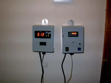

I don't have that model controller but I have something similar. I put this together before
Auberins started selling the AT type units. I have one controller to monitor flue temp,
I am using the Auberins 6" high temp probe, I think a probe will respond faster an give a
better than reading than a screw terminal TC. This controller also automatically closes
the air control when the flue temp reached 875::F.
I have another controller to monitor stove top temp, this one uses a screw terminal TC
bonded to the stove top with furnace cement. Responds faster/ more accurately, than the magnet mount I had. This controller will turn on the stove blower when the stove top reaches 675::F.
I took a look at the Auberins heater meter, it doesn't seem like it would be that well
suited for a wood stove. I would just get 2 AT units.

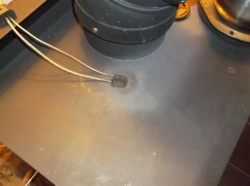

I experienced the same thing with my magnetic TC ( home made one).
I would read significantly lower than the magnetic or the IR, and did not
seem to respond fast enough.
So what I did was to take a ring type TC and remove the terminal and bond
the TC to the stove with some furnace cement with some copper filings added.
Now it is very close to the IR and the mag and response is much faster.
[Hearth.com] Auberins AT210-T[Hearth.com] Auberins AT210-T
The TC must be insulated from ambient to get accurate stove top temps.
