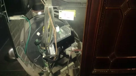

My stove did not light this morning and the error message said the auger motor was stuck. I watched a youtube video and then I removed all my pellets and proceeded to remove the back left panel as you face the stove. I chose the left side because that is where the feed hole and auger is when you lift open the top. When I looked in there Im not really seeing the auger in there so Im not sure what to do now. Is it possible it may be on the right side of the stove? This all happened when I let it get lower on pellets than I normally do. It was almost out and then I added a new bag to it. Although it did light up the next time. I have removed all the pellets and vacuumed out the feed hole in the top of the stove. I can reach down in there and feel the auger move some from side to side but it does not turn. Thanks for any help. Ive enclosed a photo of what Im seeing after I removed the left side panel.

That's the control board side of stove,the right side panel is where auger motor is located.If you run stove out of pellets it will take a few minutes for the auger to load up again.
