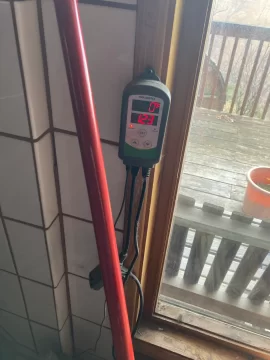

Anyway, a few years ago I got sick and tired of hearing the BK fan running continuously especially in am, and tired of bending over to manipulate the switch.

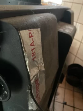

So I got an Inkbird thermostatically controlled 110v switch through Amazon. I used that silver metal tape we all use for emergency single wall pipe taping and repairs. I taped it to the top of the air plenum coming up from one of the fans before it blows over the steel convection deck.
You have to play with the control settings till dialed in.
For me a 3F gap and on at 126F works well.
When “normal” (air control ~2 area and a decent amount of fuel) it cycles on and off. When at ~2.5 or 3 and really cranking heat out, the temperature reading can exceed 130F and it’ll run continuously.
The really nice thing is that when there’s not enough heat to make a difference, the fans are OFF
Second picture is best I could get of thermocouple taped to air plenum.
