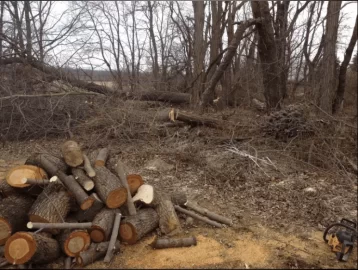

We just moved here last May, and my neighbor is a fellow wood burner. He has a family farm 5 miles down the road where he only harvests/burns Locust. One day he let me test my new saw out on a big limb he cut off a cherry tree next to his house and said I could have all the wood. Then we got to talking about how he wanted to clear out some trees next to his house so the grass would grow better. He said I could come over anytime and cut/help clear it out, and I could keep all the wood! Looks like I'll be burning some cherry in the near future! Best score to date and its 50 yards from my front door!
This pile if from that first limb he cut down a couple weeks ago...I still need to cut the tree down it came from...its to the right of this picture not shown.

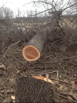

This is my first official "large" tree downing... one of several I'm free to take! I could only cut up two rounds before I had to leave for work..... and they were freaking heavy! Does anyone have any pointers as I work my way up cutting rounds from the tree? As you can see a good chunk of it is still up in the air a bit... hung up on branches.

I'd guess about 1/3 cord, nice score, you'll be busy this spring and set for a few winters to come.
That's some pretty wood. Just look at the colors in that trunk. Strange that the colors are reversed in some of the rounds.
You are seeing the difference between freshly cut black cherry and black cherry rounds that have been exposed to the atmosphere for a while. It doesn't take long.

You may want to take a look at this thread: https://www.hearth.com/talk/threads/bc-feller-training-standard-you-tube-series.142362/
That stump is not cut in accordance with proper form and safety (angled back-cut isn't as safe as a flat/straight back-cut).
Wow I was doing a reverse under cut. that's stupid of me! An undercut makes way more sense!! Thanks for reminding me about those videos!
Do most people use wedges?
There is always at least a small wedge in my pocket when sawing. If dropping a tree, I have multiple wedges handy with something to drive them.
Also, wedges often get used when bucking large wood. They keep open the kerf.

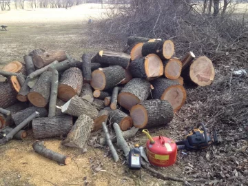

All done... Now... Do I split in place or borrow the neighbors truck and haul it to my back yard...
If you want to handle it the least, maybe split it there then load the splits and get as close as possible to where you're going to stack it. Straight Cherry splits pretty easy...

I'm sure that most people do not. But do most people use chaps and other PPE? Do most people educate themselves on the proper way to cut trees before doing it? Probably not
Most (if not all) professional fallers use wedges. As described in the videos, a wedge keeps the tree from setting back on the saw (which would pinch the bar and really screw things up), keeps wind from bringing the tree backwards, and a wedge is used to force the tree to fall in the direction you intend.
For firewood cutting the wedge can be used to keep the bar from being pinched while bucking. Set a wedge as soon as you're deep enough into the cut to prevent the wood from pinching the base.
I'm just a firewood cutter but there are several things I ALWAYS take with me when cutting. Saws, PPE, axe, tool-kit, fuel/oil, wedges. Every time I leave home to cut wood I have at least a couple wedges.

Split the wood there and get it out however you can.
