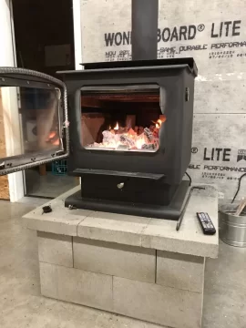

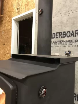

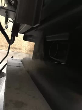

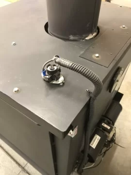

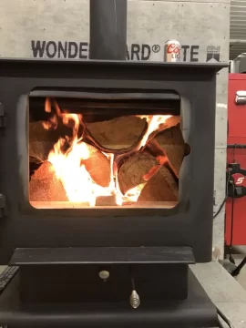

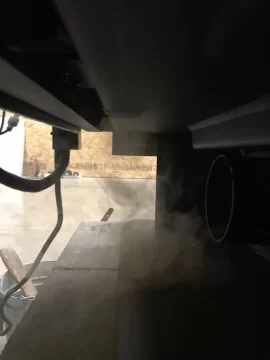

In another thread a member believed he had smoke spillage out of the back of his stove and I disclosed that I often had smoke backdraft through the secondary system of my noncat nc30 even though the primary inlets and the chimney were working properly. This is repeatable and I took some photos today.
It only happens when starting a fire in a cold stove with the door open. The secondary system flows properly once I close the door.
35 degrees outside, 55 degree stove.
  • [Hearth.com] Backdrafting secondary system, chimney drafting normally
No spillage out the loading door, drafts like a champ. All vertical 19 foot chimney. Just a part of the smoke gets sucked into the secondary system.

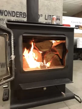

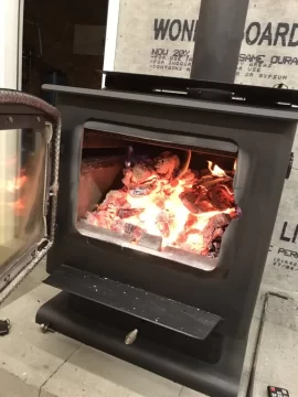

20 minutes later. 725 stove temp and 350 pipe skin temperature. This stove is a hoss!

Like i said in the other thread the only thing that makes any sense is that the large ammount of air being sucked in the door is causing negative pressure behind the stove. I have no clue if i am right but its the only thing i can come up with.

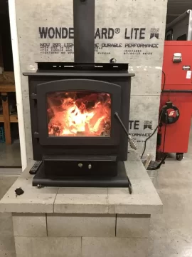

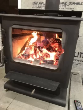

One hour later and we’re well past the peak of the burn. Flue temps down to 250 and coals, 650 stove temp and falling. Time to give it more air.

Absolutely. The square hole puking smoke feeds only the secondary air manifold. The ash plug is under an inch of ash and the ash drawer opens to the front.

I dont think its anything unnatural or to worry over. Its just a cold chimney and a stove stuffed with wood. The smoke builds and just goes where it goes. Maybe if you have a cold stove you could try to start a smaller tinder fire until the flue is warm before stuffing it so full. The smoke rises and hits the cold logs and simply lingers there instead of getting sucked up the flue. The secondaries are right above it and get filled with the smoke. Small kindling fire until the flue is warm. Then the big logs. JMO.

I know it’s not lack of chimney draft because as soon as I get the door even within 4” of being closed, the chimney sucks every bit of smoke up. The open door allows tons of room air to satisfy the chimney draft and so there’s a lower than normal vacuum strength in the firebox.

Oh and another thought: I have never seen it recommended to leave the door swung wide when starting a fire. Slightly cracked maybe. Why would the secondaries draw correctly with a gaping wide door and a cold flue? I think its just extreme startup practices causing it.

It’s weird, the young fire is lively with no visible smoke accumulation. It’s growing, getting hotter, and then this white cloud sneaks out from behind the stove.
If the stove used a smarter design where all intake air came from one tube this might not happen but there are 4 separate intake holes on this stove. Only one is somewhat controllable with the draft control lever.

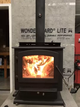

So now 2 hours into the burn and the fans have kicked off. 3.5 cubic feet of fuel reduced to just cooking coals. If it was daytime I would reload now. Flue temps under 200, stove temp near 400, room temp has climbed to 72.
