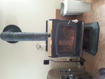

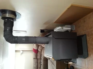

I don't recall one with a rear intake that is adjustable on the Drolet. Normally the OAK is unrestricted. Can you post a couple photos of this installation, front and back? Something sounds jerry-rigged here and it could be dangerous.

[Hearth.com] Backpuffing - HELP! [Hearth.com] Backpuffing - HELP! [Hearth.com] Backpuffing - HELP!

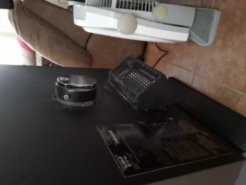

Sorry, they are all sideways...It's an HT series. Can't read the exact model number, it's punched into the metal plate and from the angle, unreadable.[Hearth.com] Backpuffing - HELP!
You can see in this image (sideways) the rear intake I'm talking about. It has a cover plate that you can rotate to allow more or less air intake.

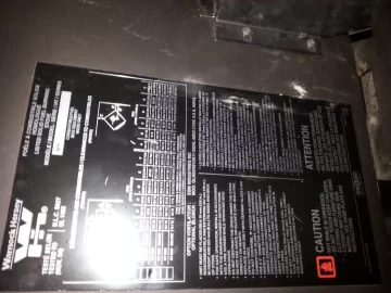

Looks like 8" with a high insulation thimble. The stove is not the one you provided the link to (Drolet Baltic.) This looks to be a bug on Drolet's website. It looks like a HT2000? Unfortunately the camera flash completely whited out the important model info in the upper right of the stove label. If you can provide that we can narrow in on this stove model.
I have never seen a valve on an intake (if that is an OAK connection) like that before. Did you get this stove used?
The model number isn't whited out by the flash, you can't read it. It's punched into a small metal plate, and from the angle behind the stove, you can't read it. It is an HT model, but that's all I can read. It's more similar to the HT2000 ((broken link removed to http://www.drolet.ca/en/products/wood/ht2000-with-pedestal)) than the Baltic. The stove was in the house when we bought it 2 1/2 years ago. Not sure how long it had been in here before that. House was built in 2006, but there were 2 owners before us. People we bought off of were actually going to take it with them when they moved...with the stresses it is causing me, I almost wish they did! LOL
