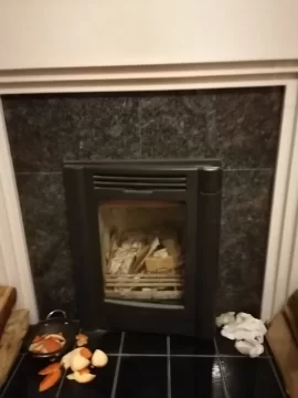

It occurred to me that I should have really put some pictures of the stove here to give more an idea of what I am working with. Where a magnetic thermometer could go on this that would give an accurate reading?

What stove make and model is this? It looks like the best place to read the temperature will be on the door above the glass and below the slats. If you get an IR thermometer, be sure it can read up to at least 1000ºF.
