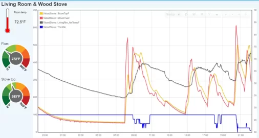

I just posted this note in another thread - for my Jotul F400, the manual is very specific about where on the top plate to put the magnetic thermometer. I suspect most stoves will have hotter and cooler spots, so you should measure in the same place. That said, I find comparing stove top and flue temperatures is very useful. I've installed some thermocouples connected to a datalogger recording stove temperatures. Flue temp are greater than stove top when stove is heating up. When stove is stable or cooling, stove top is hotter than flue, which I take to be a sign of good secondary burning.
