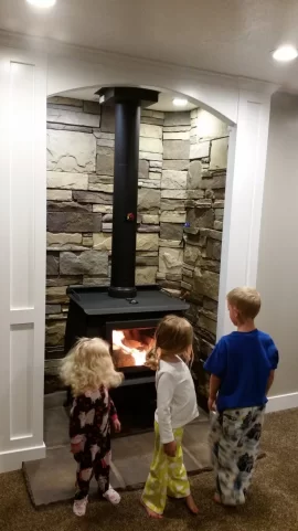

I put a King Parlor model in my basement about a year ago and absolutly love it. I had a 6" flu from the previous EPA secondary air stove that could not keep the house warm enough and required loadings every 4-5 hours (yuck!). We decided we would rather run the furnace, or get a bigger stove. I decided to take the chance and install the King on the 6", as I have a 30' straight up internal chimney in the center of my house.
The only issue I have is when I get off of the 48, 24 or 12 hr re-loading schedule and have to throw a few logs in on a hot fire to keep it going while I am away (or asleep). It will let a few whisps of smoke out into the room if I am not quick enough. 95 percent of the time I am re-loading on a bed of nice, friendly coals and do not get any smoke spillage. From what I have read on this site, that is not much different than what I hear from folks that actually have an 8" chimney.
FYI, I loaded it up last night at 8pm and a 71 degree house (upstairs) and woke up at 7:00am to a 70 deg house (upstairs). It was -2 deg outside and blowing. Lots of coals left and CAT still active. House is a 3400 sq foot 5 yr old rambler.
  • [Hearth.com] big basement stove
Reactions: fox9988
Clean glass too!
Flying pile, that's really cool looking! Impressive, especially with no blowers.

Ya, this time of year the glass stays nice and clean. I do use a blower when it gets down in the single digits and below, otherwise, the basement gets too warm. I installed a blower between the floor joists that sucks air from the floor upstairs on the other side of the house and dumps it out above the stove in the alcove and circulates/rises back up the stairway.
