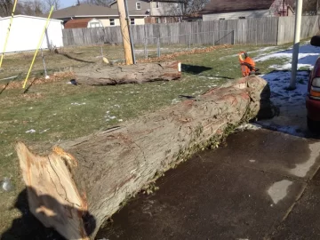

I got a call from a tree service wondering if I wanted any Hickory. They said it was laying in a back yard and I could take all I wanted. What ever was left Monday was going to their burn pile. It was bigger than I was expecting.

It was ~24". I cut it into 16" rounds and rolled them onto my trailer. That's where they sit until Tuesday.
Not sure how I am going to split them yet. I have a friend with a splitter I may borrow, but it is horizontal and I can't lift the rounds on it.
Use wedges and quarter it?
Noodle it? My little 450 wouldn't like that too much and my 268 needs repair.
