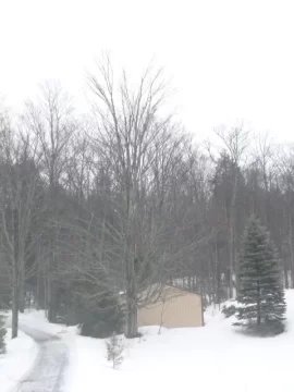

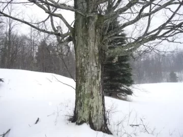

I think if I could find someone with a portable mill that may be my best option, but even that wouldn't be cheap. Here's a couple pics of the ole girl:

There's probably a couple nice slabs in that trunk. But it being silver maple, that stuff dents easily. Not so sure I'd use it for a table, but that is up to you.....
First thing I'd be doing after dropping the tree is to see if it has any metal in it. Cut it down, get it into a log form, and watch the butt/top ends of the log for blue streaking......also, use a metal detector the whole way around, and up and down, that log......set the detector on the most sensitive setting you can.....

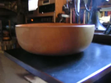

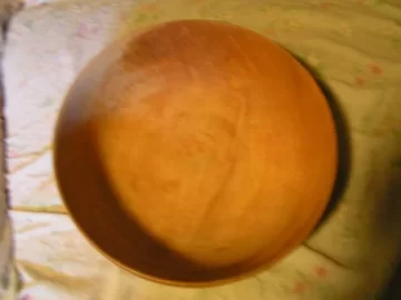

*ahem* ;) Silver or Red Maple are also good for workbenches,they may seem a tad soft for the top,but are just as hard or a little harder than Doug Fir & some Southern Yellow Pine - and they are used all the time in user-made & lower cost factory made benches.

Ahem.... Thats hard Maple folks.

It's funny you say that. I have mostly hard maple here (like 90% of my maples). I never paid too mention attention to the tree (other than wow what a beautiful maple) when we moved here. I really noticed it getting real sick late this summer but never focused my attention on it enough or remembered to scope out the leaves. I've only recently decided it's gotta come down as I can now see just how sick it is. Can't see any leaves under all that snow and that's the only way I can be sure. The bark looks different than my hard maples, but it is the biggest maple I have. I had kind of convinced myself it was a soft maple, but I wouldn't be shocked if it was in fact hard.
How can you tell between hard and soft with no leaves?
Also, we can place bets on hard or soft. The winner gets to bring some milling equipment over and can take some boards back with them. ;)

I stand corrected. Now that I am on my laptop (was on my Droid phone when I mis-called it earlier) I can clearly see the deep veined rough bark on the trunk.....
Good eye, Ford!
I have a couple large (but much smaller) soft maples that have kind of rough bark, and I figured the bigger they got the rougher with deeper troughs? No? Does only Sugar get that rough with size?
yes. Deep, curling, peeling shag, too. Sometimes they don't get as rough as others. I have some sugars here that are unbelievably rough....hard to even get a tap in them for sugaring, the bark is so curly. Others aren't hard to get through the bark at all...
Cool. It's got be sugar then. Some of the bark curls on that tree are almost as long as my hand.
