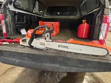

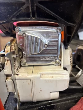

Gave the MS261 a good cleaning and chain sharpening, also added a Billet exhaust to give it a little something extra.

And what's the verdict?
Sound better? Louder? More power? Or just more shiny?
My 362 also has the M-Tronic, no complaints, I had never thought that it would compensate for a different muffler, but makes sense.
I'd imagine that I'm off to the aftermarket chainsaw rabbit hole now...
Much better throttle response, definitely louder! this muffler has dyno sheets that show it increases power by 13% and torque by 19%. Haven’t cut anything yet so that will be the real test to see if it cuts faster.
The instructions that came with the muffler specifically state no adjustments needed for m tronic engines, but minor adjustments needed with traditional carb

This is made by a small shop
Out of Iowa I believe, he does his own port work I think too, I feel like Ive seen pictures of stuff he’s done.
