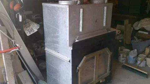

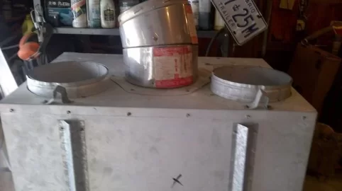

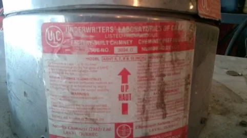

Hello all again,
As I stated in another post, I am pulling out my BIS fireplace and putting in a new stand alone stove. I am not sure what I will put in yet but I wanted to know if I could use my current chimney. Here are some pics of what my fireplace looks like and where the chimney attaches.

That will depend on the new fireplace requirements. You have Security ASHT pipe there. I think this is approved for use with the BIS Traditions (or Lennox Montecito) fireplace.
I am looking at getting a stand alone stove. Maybe a Cape Cod or regency.
Hmm, I think it is class A and it may be fine, but I can't tell you that for sure. Their current class A pipe is Security ASHT+. Not sure the difference. Give Security a call to be positively correct.
