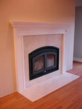

    Had my BIS tradition installed for about a month now. Have to say I am impressed with some issues.
    House is 3500 sqft, open plan, and vaulted ceiling in most rooms. From cold it will take maybe 5 hours to warm up the house to around 70 so I've learned to keep it running all the time. With half dozen logs and both dampers fully closed I can maintain 70 degs in all rooms (hotter in the room with the BIS) for 6-8hrs. I can get over 75 around the house with the damper opened. It's real easy to over-fire, just running the left damper half open generates an uncomfortable level of heat. The whole marble surround gets way to hot to touch... Blowers hit or miss, comes on when hot but turns off when even hotter. In contrast the fan will still be going the next morning when it's cooled down?? The fan is too loud at max speed and doesn't provide a detectable difference in airflow from the top grills. Having said that I run it half speed to in an attempt to keep the surround from getting too hot. still fairly new to me but we certainly aren't cold anymore :)
    pm me if you like for specifics
