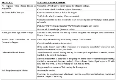

i think they want you to hit start again without cleaning the first try pellets out. probably just to verify it will fire. sometime if you run out of pellets it takes a couple tries to get pellets delivered to the pot in the start up cycle. They have a real nice owners manual.. good troubleshooting section
