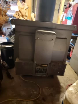

My BK Princess has nothing following the PEJ model. Does anyone have a idea if this is a 1000 or what?
6-8 years ago I put a steel cat in it, although it lasted a long time the burn temp. is too high and i'm cleaning the chimney 2x a year!
I'd like a cat that lasts 5 years or so but burns at a lower temp. than a steel one. I'd appreciate suggestions.
Thx, Jim

I sure appreciate the replies, wasn't expecting this much!! any ideas on what material would be good that lasts for a few years in a cat? (ceramic, steel, etc.) also; any idea what should be after that PEJ indicating what model/series? I am in contact with Blaze King to avoid shutting down the stove to measure for the cat but I let it burn out last night to measure today. still, I wonder about these two questions.
The cat definitely sounds like it needs replacement. Can you post a front and back picture of the stove for identification?
@BKVP PEJ-1002? Does this take the same cat as the KEJ-1101?

Get me a clear, closeup of the label and I can provide clearer information.
BKVP
when magnifying this i see that it isn't real well focused. Since I don't know what you might be looking at here with the overall pic of the label I'll wait till you see it and you can tell me how next to refine the pic. I do note it was built in august of 1984 making it 40 years old, that's impressive but looking inside it's totally believable. the cat is 6" in diameter. (what's left of it)

Likely 5.66" diameter if it is round.
BKVP
I see most combustors on amazon are 5.83" dia. I just used a tape and I couldn't measure exactly across the hole as the cat is in the way but it looks swelled to the same dia. as the hole. It's just my luck it has to be measured within .100" !! I could of gotten my Brown and Sharp calipers out, I also note they sell a ''wrap'' that goes around the combustor to make a tight seal in the hole.
I'm sure the hole was stamped at six inches, your stated 5.66" will fit and allow room for this $23 foot long 'wrap'!
I see a condar model cc-005 for ''early blaze king'' that says it's 6" in dia. they could be off a half inch?? it's platinum and pallidium coated for $172 and if it's 6" already has the ''blanket around it''. I'll look at things besides amazon though.
if/when i get the right stuff for this stove i'll make a tag and tie it to the stove !!
Thx much to all.
Condor buys combustors from suppliers. Your stoves combustor was made by Applied Ceramics. AC sells to Midwest Hearth. 5.66" + interam gasket is likely your size. Best option is to remove the one in the stove and confirm measurements.
