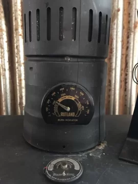

Do you have a probe flue temperature gauge?
That's too close to the flue collar and not a probe thermometer designed for double wall pipe.

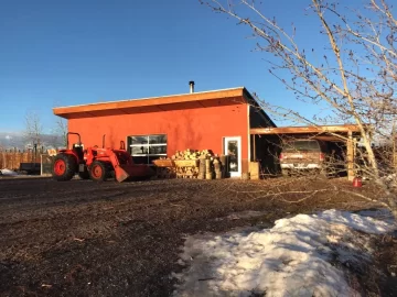

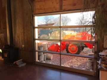

Whats with the metal wall in the background is the stove in a shed, the ground also looks like concretE? If your stove is cold and your room is even colder your gonna have problems. How are you building your fires from a cold start?

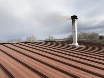

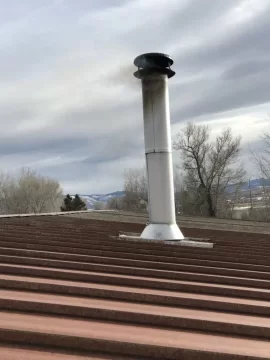

It was a 40F day with lot's of wind. I noticed it was a good day with good draft in stove and after reaching the active temp I activated the cat. Was waiting for typical smell but nothing happen. You must be right begreen my draft is only marginal despite being 4 feet above the roof. I might have to extend it another feet or two and support it. Thank you all for your help.
PS: Building cold fires from a start is no problem, corrugated metal is the inside wall siding and there is a concrete floor. 4800 elevation

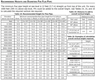

Your elevation may also be a factor. If so, this is going to require additional flue above the minimum.
I tend to agree that this sounds draft related. Just a small change in pipe length can make a big difference. BK's seem to really like 15' +
Here is a link to the type of probe thermometer you need for double wall pipe. The magnetic type are designed for single wall applications this one will allow you to know what is happening inside the pipe. As has been noted it should be 18 inches or so above the stove top.
Send us some more pictures that looks like a really nice place.

This chart is for the Enviro Kodiak, but it will give you an idea of the effect of altitude on flue height. Note that the minimum height for the Enviro is 12', not the 15' that the Ashford requires.

That looks like a beautiful set up for a work shop! I just love the glass garage door... Awesome! :)

Those pics just really made me miss billings, used to live out by the yellowstone and ride bikes in south hills :(
