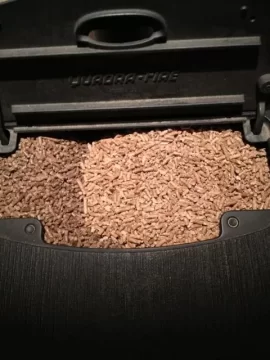

Look at the crazy color difference in these two pellets. On the left is HDX from Home Depot. I'm assuming these are Heatrs as I have a few bags of these and they are very dark like this. On the right is beetle kill pine from Ecoflames. Those have been my staple and favorite so far this winter. The Heatrs not so much.
It's funny, I used to live a few miles from the Heatr plant in Showlow AZ and burned them exclusively. They were never this color. I'm thinking they're using scorched logs from that huge fire down there in '02. I'm guessing here, but that is the largest stand of Ponderosa pines anywhere, and they're not this color unless they're burnt.

Good morning Dinger.
What may appear to you to be a "crazy difference" is actually relatively routine. The variance in color from brand to brand , or in some cases, varience in color among batches of the same brand, is caused by many things. The main reason is the species of wood used will contribute to variations in color. Others include bark content, sharpness of the die in the progression of manufacturing, (as the die dulls , the color of the exterior of the pellet dartkens due to friction) the bark composition percentage,as well as the age of the sawdust. As sawdust sits outside, it will darken with the elements, and the older dust is darker in color than the new dust. Many times pellets will look different than other pellets, but it is never a conclusive indication of a problem. In your pic above, you are comparing what looks like a hardwood pellet vs a softwood pellet, thus explaining the difference in color. I will agree with you on the Eco Flames though...good solid super-premium softwood pellet, by Confluence Energy in Colorado.
Everyone thinks "bark" when they see darker pellets. Its not always the case. Wood naturally turns darker when it is seasoned. Saw dust piles left in the open elements and solar exposure will become darker from what I have heard.
Maybe some of the pellet mill peeps can offer some input. Their word should have more weight than mine!

This initial moisture content of the wood will affect the color a lot. The more energy (heat) you have to apply to dry it to the correct moisture, the darker the pellets will be. The beetle killed wood for example was probably dead on the stump and pretty dry to start with.
The time of year it was made will cause the same effect. Lighter pellets in the summer when the wood is dryer, darker in the winter when the wood is frozen. It takes energy to convert the moisture from a solid to a liquid ("heat of fusion") before it can be converted to a gas ("heat of vaporization").

I guess the colors got my attention because I'm thinking these are the same species, just from different areas. My focus is on the pellet on the left. Like I said, I used to live right there, in fact I was evacuated for nine days during that fire in '02. I went to Colorado on what my wife and I called e-vacation. After that I moved here as soon as I could.
Could they be using raw material from that burnt stand of timber? That company used to use pulp from all the sawmill operations in the area. That all but dried up over the last decade so I'm sure they had to find a different source for raw materials. I still know a few peeps in the area so maybe ill put in a call for S&G's, inquiring minds want to know.
Another thing that can cause darkening of the pellets is how hard they are running the presses.
As the material is fed through the pellet mill, the die heats up, and if it gets a tad too hot, the pellets will get a slightly darker shiny finish to them.
Having the die at just the right temp makes things work just right, and too hot will actually burn the material slightly.
