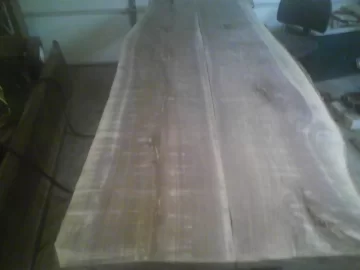

    More pic's to follow.. Harvest table 36 inchs wide by 9 foot long!
    Just water, sence then I have sanded down to 600 grit.

    That looks great, just wait until you get some nice clear on it.

    what sort of joint did you use for the two halves? Biscuit? Looks great. Now come take down this walnut at my place and make some more.

    We use hickory boards across the bottom clamp it and screwed it. I have a biscuit joiner but never would have held these slabs.

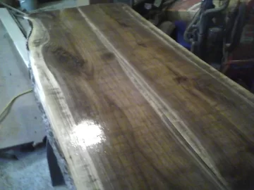

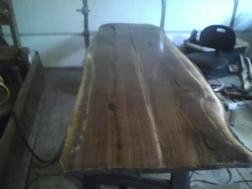

    second coat of clear...600 grit sand paper moving up to 1000 tonight.

    What are you planning for a base?? A nice Pegged through tennon would look pretty good with that.

    To how high of a grit are you going? are you applying more clear between the sandings? My recent method has been using 0000 steel wool between clears, then when I start doing the final sandings I have started wet sanding. It's harder to do inside than it is when you are wetsandig equipment/cars outside, but I'm really liking the results. Usually I'm wet with 800, 1000, 1500, 2000 then I've even buffed with an automotive buffer. You can't do this if your clear isn't rock hard and plenty thick. Try it on a smaller project sometime and tell em what you think.
    It's the craziest thing how the wood looks with a crystal clear glass smooth finish on top. Don't know about the durability for a giant harvest table though, maybe a nice semi-gloss would work best for that application.

    Its going to be two pedestals made out of a big walnut limb 14 inch's wide. Pealing the bark off and that's it. There will be a board to connect the two pedestals will be a mortise and tendon there.

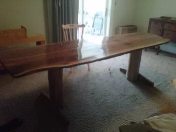

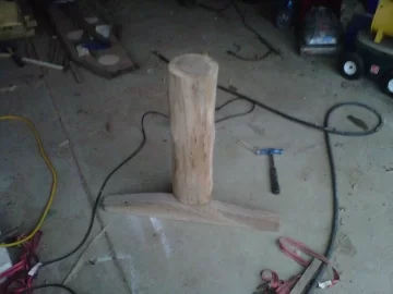

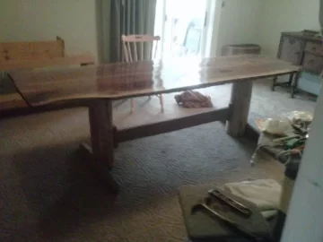

    Up date.
    May just make the dead line!
