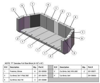

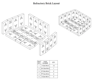

Looking at the firebrick layout for the FPX Hybrid Large I have a hard time convincing myself this is a 3.0 cu ft stove. Based on the firebrick alone it looks like the Ashford 25 has a more usable layout and volume. I am assuming the Ashford 25's "A" firebrick is a standard 4.5"x9". What do you think?

Thanks, on the back of a napkin I get ~ 2.0cu ft loading to the andirons as recommended and allowing a 12" high load size or 2.4 cu ft allowing a 14" high load. Methinks they may be using total firebox volume and not usable firebox volume in the spec.

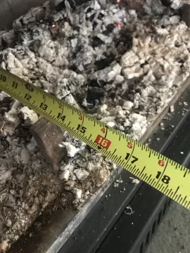

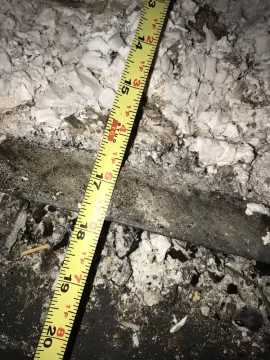

Oh , yeah . It’s total volume that listed . That why I’m trying to figure out useful volume . How wide is back wall on your Ashford 25 ? What is the distance from back wall to the point where you can still load wood? ( in my case andirons ) How high you can load it from the floor of firebox . I’d really appreciate the actual measurements

It is 17 3/4” from back fire bricks to the door seal. As you can see using wood that sits on the ledge if using wood that is really ashy it makes a mess and falls on the ash lip when the door is opened. When using wood at 16” it is much better at keeping the ash inside.
I can get the other measurements here in a couple hours, it’s still chugging along right now but will reload soon.

16 in is reallly impressive . I’d really appreciate back wall and height measurements.
Back wall brick to brick is 18”
Front opening brick to brick is 22.5”
Floor to dome guard is 10”

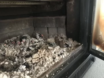

That's almost exactly what I guessed from the brick pattern. Does the 10" height clearance increase in the front of the firebox?
I can measure in the morning but the height of the cat plus maybe another 1/2” for the guard.

If 10", I come up with a usable firebox of a bit more than 2.0 cu ft giving a 17" depth. It would be a tight fit for some of the big splits I am burning.
