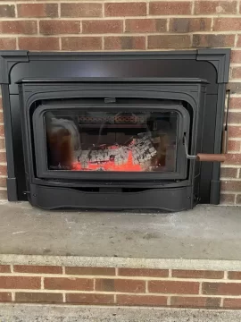

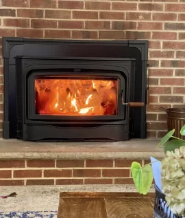

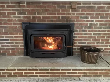

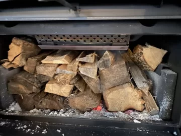

Hey all,
I've been a member here since 2018 and did a lot of my research on wood stove inserts using this site and forum. I finally pulled the trigger on a Blaze King Ashford Insert this past spring and I'm finally getting to use it after breaking it in with several small hot fires to cure and remove the new stove smell. I'm based in a suburb outside of Philadelphia, my home is a 2-story 2600 sq ft home. My primary heat is gas, and I purchased this stove to offset my heating costs. After installing the stove, I opened our living space and installed fans to distribute the heat throughout. I've been very happy with this purchase, with the exception of my short burn time. I've been using the stove in the mid-30s - low 50s (it's only November) and my longest burn was 3hrs, which is way short of the advertised 25 hour burn time on low. Now provided, I have not turned the thermostat down to the lowest setting, but I generally turn it down to 2 or 3 o'clock after the fire gets going.
In preparation for this purchase, I have accumulated a couple of cords of firewood, and here is where I think I went wrong. I started purchasing firewood 2 years in advance, some of the pieces range from 14" all the way up to 24" (can't fit them in) The wood is seasoned and maybe too seasoned, I've split wood and have taken several readings from 9% to 15%. The result is I can't keep the fire going longer than 3 hrs. I found this thread helpful, but I think my wood is definitely too dry instead of wet.
So here's what I'm doing, for a cold start - I generally load up the firebox with some kindling, that I burn down to coals, I distribute the coals evenly, and then prepare my main load. I have to pick through my supply to find 14-16" pieces which I load about 4 into the firebox North to South and then find 2 larger 18" long thick splits east to west. I leave the door open a crack to force some air in to get the load going. After about 10 min, I close the door. I wait for the thermostat to get just into the red to engage the combuster, I wait about another 10 min or so and then slowly lower the t-stat. Usually about 2-3 hrs I have a bed of coals.
I've searched this forum and found some threads that have helped me narrow down possible issues, but honestly, I think it could be my wood supply, but it also could be other factors that I'm not aware of. Draft too strong? Possibly not filling the firebox due to the size of my firewood?

Appears that you are starting a partial load at best as shown in pic 4.

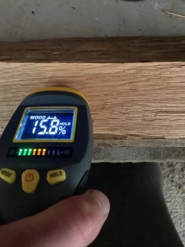

Are you re-splitting a selection of your splits that are up to room temp for M/C testing? Test the freshly exposed inner face of the re-split immediately after splitting for a accurate result. Any other test method yields nearly useless data.
Your near Philly. Highly unlikely/impossible to have naturally seasoned wood that is "to dry".
May be worth going back to basics and read the operators manual carefully. Start a full load and follow the manual to a T to get a baseline.

@moresnow yes, so I bring in wood in the AM, sometimes 24 hours in advance, and then split and take a reading. My past two orders of firewood - they said they were seasoned, but I don't know how long as I took a reading right away and I was getting close to 30% MC, I let it sit for 6 months - that's where I'm getting 15-18% MC. Its not Oak, but a mix. I know I am not filling the firebox right, but according to the manual a load of 4 splits N-S and 2 larger ones E-W should be a normal size load, but due to the cut size of my supply Its often a tight fit to get that, so it quite possible the load size is the culprit.

You must load the stove fully in order to get the maximum burn time. Packed tightly with large splits. And then burn at the lowest possible burn rate without the cat stalling. I enjoy 24 load cycles with softwoods from the princess model but I load the thing tight!

Completely understood. Sounds like your sneaking up on the whole scenario nicely. 15-18% sounds appropriate. Have you monkeyed with cutting some of your splits to fit better/more? It's a pia but payback is nice. I've had to do it after having a buddy who has a large add on wood furnace "help" me cut wood. Once!
I need to see what a full load looks like when packed into the insert. Today I picked through my supply and found 14-16" pieces. I say they are kindling size at best. Not large splits. Can I just pack them in, all the way up to where the combuster sits? The overnight low is 29. Im hoping it is just me being timid about filling the stove and not something else. Will report back. Thanks!

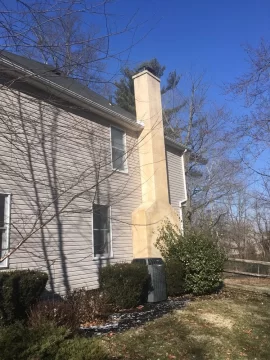

Also how tall is your chimney
Yes, wedge the pieces in right up to the roof and with as few air gaps between the splits as possible. There is no max fill level on this cat stove. Take a photo for us of the load to help diagnose.
Obviously, you need some amount of coals and seasoned wood to do this so that the load can combust.

The chimney is 25ft... In the photos I posted earlier, the thermostat has been turned down to the 3 o'clock position, the flames tend to dance around when I adjust, so that is probably that "intense" look, when i turn it all the way to 12, its basically black inside, although i can see the glow of the catalyst, but with a large window of the insert, I kind of want to see something... :)

I agree with others, pack that fire box full, then using pic 3 - when the fire is fully seated turn the T-stat down to 1 o' clock, find that sweet spot where you have whisper flames but very active glowing cat, turn your blower on and enjoy. In other words, your burning to high and wasting a lot of potential heat, you will be pretty amazed at how much heat comes off the unit while burning low and steady, candle like flames are your best friend with the glowing orange cat.
*this may take a 6 pack to find the correct burn rate, wait approx 25 - 30 min per adjustment so the fire can get acclimated, and its very important to make sure the fire has been seated like in your pic 3.

Time for a reload. First time packing it this full. Hope I'm not doing any damage... How is this looking? ;em
The stove is designed to be packed that full. So long as the thermostat is working and the door gasket tight, all is good. The problem I see is that you have a load of kindling there with a lot of surface area that will all be engulfed at once. The cat will try to keep up and thermostat will try to slow it down but you are going to be dealing with a candle burning at both ends.

25 ft is tall. Is there space for a key damper (tough in an insert). Has the draft been measured?

Previously stated that MC was anywhere between 9-15% but those pieces were on the small size. I have moved on to 18"-22" pieces, and found some MC around 20%-22%. (Don't know how big a deal that is, but I usually set them aside, only burn under 20%) Because you can really only fit 2-3 of these bigger splits E-W, I've taken some large pieces and cut them on the chop saw so I could insert them N-S. Even, when I think Im loading it up to the gills, it seems like in an hour everything has settled down and there's a lot of space left.
