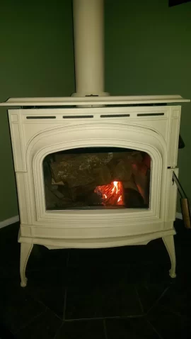

Is the cast iron top on the blaze king lowerable? That is, can those bolts be screwed in and has anyone done this?
What is the goal? If it is cooking heat, you can just lift off the top to have direct exposure to the stove top.
The bolts are screwed in all the way on mine so the top cannot be lowered, but i have cooked a stew by removing the iron top.

It's just strange to me when viewing/sitting on our sofa with the huge gap in between there cause we painted ours biscuit to match our pipe and I think it looks a little strange with that big, dark gap
Buy some shorter 1/4 inch bolts. It looks like some 3/4 inch long 1/4 inch bolts would lower it some.
We do not endorse any changes to the product as safety tested, I would comment that the catalytic thermometer probe would not fit to the correct positioning behind the catalytic combustor. You could contact Condar and ask if cutting down the length of the probe would be advisable.

If your really serious about this, paint the part of the flue connector below the surface black again, it would then be less noticeable. Or raise your couch.
Or just realize you have a great stove and get over it.
This gap is not unusual or unique to the Ashford. Take a look at Alderlea stoves or similar styled stoves that vent below a convective trivet top.

Did you use that Stove Bright paint for that? Looks great!
No I actually ordered high heat paint offline and the color is parchment. This is the only way I could have a Blaze King and pass the WAF...
