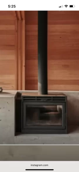

I like the look and function of the BK boxer, but I am wanting a stove that sits directly on a hearth. No visible legs or pedestal. Does anyone know if this is an option with this stove? Attaching reference pic below. Thanks!

This style is an option for some other brands, but I don't think it's available for BK stoves. The Boxer base is required.
Reactions: BKVP
All safety test were completed with base attached. Thank you BeGreen!
