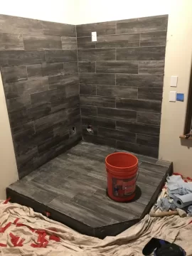

Much better location for the F/A. Tile looks great! How much beer did it take to get the tile installed?
zero :( I was on call all dang weekend. First ever beer free home project. There were no injuries to report and limited flame outs and or tools being launched across the yard in anger.

What's the outlet up in the top row of wall tile for?
It’s randomly there from the old gas stove mantel. I bought a black outlet to match the tile.. might leave it, might cap the wires and do a black face plate, might put a mantel there later... not sure!
A small sconce light would be nice, sometimes before bed I go down to check my BK's settings, having a low light helps see the t-stat setting & whether the active needle is where you want it.
