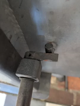

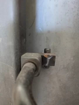

Made my own little catch for the door latch, just ... because. The OEM didn't quite allow getting it tight enough with my tired old door gasket (but of course still leaky around the hinge, so needed new door gasket anyhow, which I did). I think it looks cool too.
[Hearth.com] Blaze King latch replacement?
Used a button-head bolt (allen-key drive). Used 2-1/4" and needs to be fully-threaded, which is a little hard to find, had to go to Fastenal. I threaded the little piece of metal, but put a jam nut on there too. Also used a serrated flange nut, seems a little more secure than an ordinary hex nut.
Use high temperature antiseize paste on all applicable internal threads of the nut(s). I learned something from the previous iteration, used it when new stove was getting installed.

I'm surprised you threaded the metal tab/catch. Doing so prevents you from clocking it so you are still stuck with full turn adjustments. I would guess threading it did help lock it in place though.
no? Loosening the locking nuts allows to rotate the bolt with arbitrary angles (followed by retightening the locking nuts)? (And once a full turn has been done, one can rotate the tab to not loose grab of the bolt in the hole.)
Whoa, just saw this discussion was active .... I think I decided that there's no reason you need better than 1/16" of precision on the latch setting, which means 1/32" is the farthest you can be off from ideal with 16tpi threads. I should've located a 24ti bolt though.
But I threaded the tab piece, so can't just rotate it freely on the bolt.
Reactions: stoveliker
I think stoveliker is proposing that you back the locknut off of the threaded tab, turn the threaded tab as desired, and then hold it while tightening the locknut against the tab to get infinite adjustability. This would mean that the threaded tab would not be locked against the button head.
