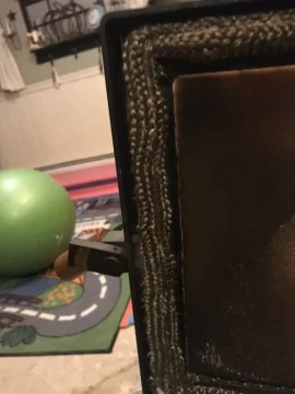

I can not get the door gasket to pass the “dollar bill” on the latch side and the top on latch side. Before the start of the season I replaced both the door and glass gaskets. This is the 4th or 5th time I have replaced the door gasket over the course of owning the stove but the first time replacing the glass gasket so I think it could be related to that. The grove from knife edge on the rope gasket is way off center on the gasket. I am assuming the the little channels that bolt down to hold the glass need to be moved to allow the knife edge to center on the gasket?
Also, I have no more adjustment on the latch so I can not adjust that any further in.
any suggestions?

Is this an oem bk gasket? It doesn’t look right.
Yeah, you need to lay that gasket onto the silicone evenly, taking care to neither stretch it or bunch it.

While I don’t like the door gasket on top of the studs and nuts for the window gasket I seem to have resolved the leakage potential issue by laying a deep bed of silicone for the door gasket. Deep enough to be nearly level with these nuts.
It does add to the complexity of door gasket replacement because you need to lay such a deep bed of silicone and you must resist the temptation to push the rope into this deep bed while setting the new gasket. Pushing the gasket down between the nuts could cause low spots. Bed the gasket with the flat door frame on the stove!

4th or 5th time replacing the gasket is far too many times in the length of time you've owned that stove.
Remember, the bill needs to merely be snug, as is in not wiggling back and forth easily. If your looking to have the thing hard to pull out, it's too tight. As long as you're getting a slight knife edge indentation into the gasket, you're good.
It does look a little twisted and wavy in the photo though.

They did improve the door latch design to make it way easier to adjust in the last several years on the old princess/king line. The inside nut was previously welded in place so you had to tighten the latch by one full turn at a time. Now, with two free nuts sandwiching the stove body, you can tighten the latch any amount you want. Also, the nuts can be replaced if the threads get buggered up.
I would assume so, It was purchased from the dealer in which I purchased the stove from.
Yeah, that doesn't mean anything unfortunately. Could explain why you've been through so many gaskets in such a short amount of time. Unless you specify and receive authentic BK gasket you could be getting anything.

Interesting on the deep bed of silicone. I was always under the impression of a small bed just enough to hold the gasket in place and then lay the gasket in evenly without stretching or bunching. It has been a few years since I have read up replacing them. When i did my research on replacing it the first time that is what I came up with. That was 5-6 years ago. I will redo it with the deep bed and see it it is better. Just never had an issue In the past.

I have replaced it each year after the 2nd year at the advice of the dealer. I had the Cat fail the second year because of the loose seal (it was assumed that was the cause). I figured it was cheap insurance.
As far as the tightness it is not nearly tight enough in these two spots.The glass is getting black right where it is loose so I know it’s not sealing properly.

If not for the extra giant nuts and studs in the gasket channel you would be correct that the silicone is just an adhesive but since there is all of that hardware laying in the channel you have to fill the low spots to get a smooth surface which will press on the gasket evenly. Don't twist, bunch, or stretch the gasket. Just lay it in there straight and flat. If you must push on the gasket to stick it down, only push on top of the studs lightly. Get it on the stove with the latch fully loosened and shut the door gently. Check for RTV spooge out and clean it up.
can an OEM gasket be purchased directly from BK online?

The last time I bought one I ordered it through my local dealer (had to specify that I require the BK gasket) and it was shipped directly to me from BK.
