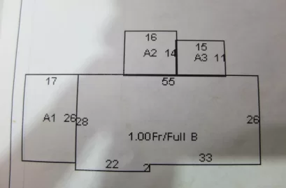

I have attached the house layout. The insert is installed on an interior wall. It is located where it says 28 and faces the larger part of the house. The room that it is located in is 28'x22' (616 sq ft). The entire house has 8' ceilings. What I find strange is that the hot air doesn't get too far into the room where we sit. Seems it is a bunch hotter at the ceiling. Bend the fins on the vent down? Thanks Weather guy…I know that the stainless steel liner is insulated and sealed off at the cap. It doesn't have a block off plate. If this is needed, why didn't the dealer that is wett certified and installed lots of these do it? In regards to the wood situation, I live in suburbia. I buy my wood from a seller. Sure he said it was seasoned, but ??? I don't have a good moisture meter, but so what? At the end of the day, I have to burn what I have. I might have made a big error buying cat technology if my friend's blows hot. Next year, the wood will be a year older and I guess better. Doesn't seem much hotter when I throw in bio bricks either. My opinions are as objective as can be, just wish for better results

We are way overdue for a pic of this stove and install. From ten to fifteen feet away.
